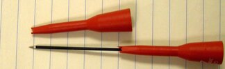

I never thought about it LOL. Just tapped it and fused a line to the relay coil. You could just pull the fuse and probe it. btw these multimeter probe tip adapters come in handy for that kind of thing.
