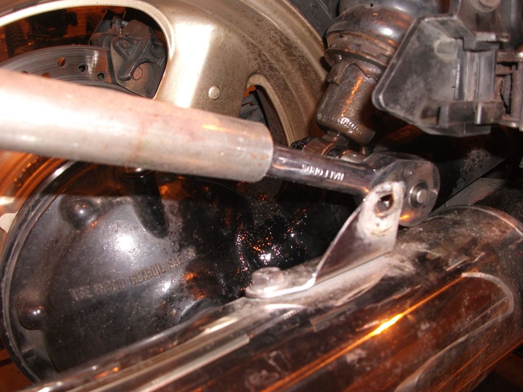

Hi folks
So fitted the shocker today, started at 7am and just as well, it was all going great, I made a brew and stripped the plastic off, now from previous time spent on the bike I new the lower shock bolt would not come out, tried heat gun with no joy, penetrating oils no joy, so finally I gave up and welded a nut over the knackered stock bolt.
Still needed a fair bit of leverage to crack the bolt.
Got the bolt/pin halfway out then had to use a long punch and big hammer to get the pin out fully. Cleaned up, and then realised that the thread part of the final drive had stripped:mad: so the bolt/pin would not tighten up................so took the bolt and reworked it on the lathe, handy thing a lathe!!, basically removed the threaded portion, drilled out to 6.8mm and tapped M8,so I could put a locking bolt in from the other side(where the damaged thread is on the f/drive).
Bit long winded but all went back together ok and didn't fall off on the way home!!:04biker:
You can see I put a lock nut on for a bit more security, I will probably order a new oe bolt and rework it the same, there isn't enough material to re tap the final drive to M10 so this will have to do for now.
And finally I put a load of copper slip anti seize on the shock bolt so I don't have this problem again. The rear end is nice and firm and the handling has improved round the twisty bits so happy days all round!:)

So fitted the shocker today...
OK, but... why is it upside down?
And the mounting bolts are a regular to be serviced item... copper slip serves excellent protecting the threads, but I use some Moly on the shafts/bushings of the shock mounts.
Sorry about the f/drive housing... :-( That damage could have been avoided...

Seems the mounts (bushings) are mixed up.
In that position you've no chance to adjust the pre-load, nor the shock valve...
When installed correctly that red collar (rebound adjust) can be reached through the hole on the RH side cover (I use the tool-kit screwdriver to give it the 5~6 clicks required)
Enclosed a (crappy) pic of my version:

I see what you mean, if you look at the first pic on the thread the mount holes are different sizes, so it will only fit one way, bit strange, I cant imagine that Wilbers mixed up the ends, will have a look at some google pics and see if that shines a light on it.

So ive looked on google and all the Wilbers units ive seen are fitted the same way as mine, also looked on another site and read a thread where a Progressive shock was used and was fitted the same way as mine.
Maybe its a difference in models, mines a 99.
I know it cant fit the shock the opposite way, im happy with the ride as it is so wont be adjusting the spring yet, it was set for solo rider with luggage.
Any comments welcome on this one.

The setting is fine for me and can always be changed at a later date, just need to drop off the side panel to get at the c spanner in, not going to worry about it really.
