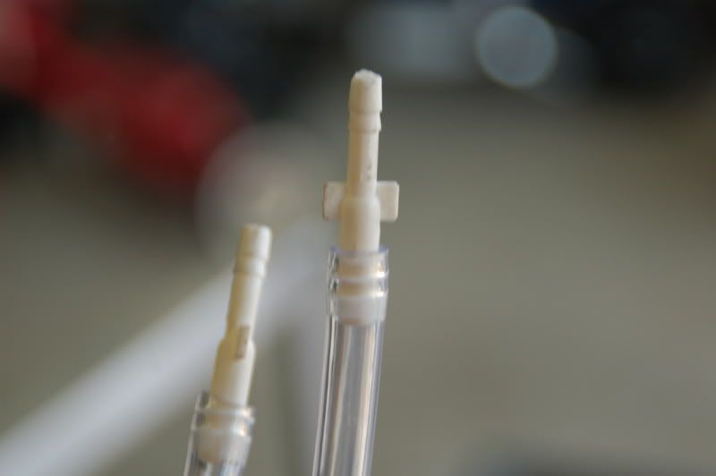

I didn't check anywhere ( service manual, internet, or just looking ST valve tubing ) for the size of the ST's Starter Valve tubing. Ugh, off to Advanced Auto Parts, to get 3/16 to 1/4 tubing adapters. Really no big deal tho.

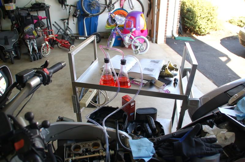

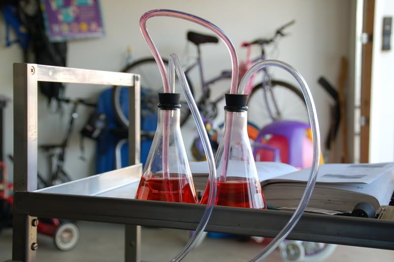

Well, It was successful. Below is my manometer - I didn't think to take pictures until I was done... the camera was too far a way . ( it was just inside the garage door.
