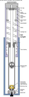

There's nothing other than friction stopping the damper base from spinning if it so desires. It is a completely circular object inside a tube, with a sealing o-ring between, and of course it is nicely lubricated with fork oil. From the outside of the fork the only things you can reach are the damper shaft and if you had a long hollow tube, you can reach the top of the damper cartridge. Pushing on the cartridge won't do much but that is effectively what the spring does when the fork is assembled, and that is usually enough friction to stop the cartridge base spinning. If you really get stuck, the best option is to pull up hard on the damper rod, that pulls up on the cartridge and applies some force to the damper base via the retaining circlip. In conjunction with heat and a rattle gun that will give some hope of unscrewing the damper bolt. The diagram below (from a Racetech installation guide) gives you some idea of how the fork/damper is assembled.
