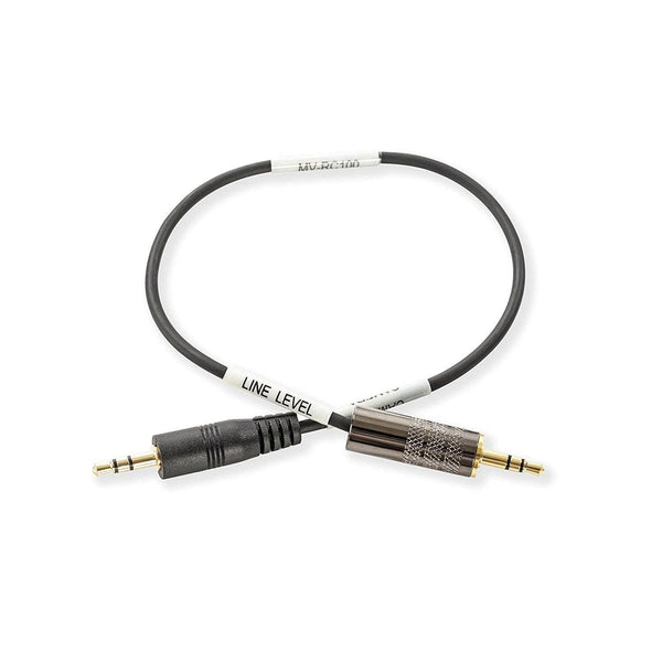

Not sure about how this unit works, or its connections, but usually an overly high volume means you've connected something that outputs a high signal (like a headset output), into something that accepts a low signal (like a line-in). Often the simplest solution is to ad an in-line attenuator to lower the signal.
Here'-s a cheap example:
Or you can even use a simple volume control and turn it down to an adequate level:
There are other, more expensive, version of these as well. You just gotta get the input level lower.
