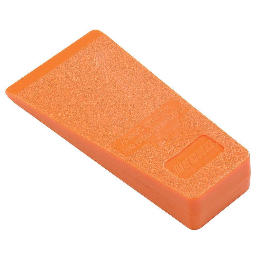

I just use some plastic wedges to hold the tire down in the drop zone and then remove the tire with no problems.
That looks like a pain in the rear end. :think1:
Got a pic of those wedges?
