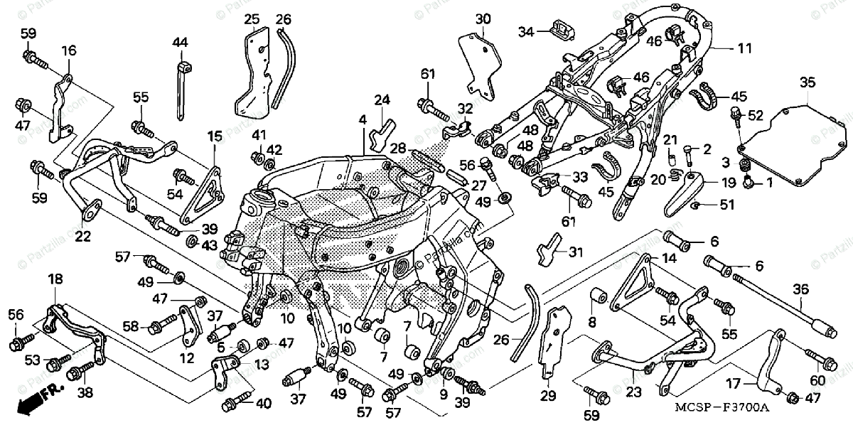

General opinion was to remove RHS fairing, so whilst doing that removed LHS fairing, cowls and other sundries, and took opportunity to give the bike a good scrub, was tempted to put some of the small pieces in the dish washer, but had a better idea ...... put 'em in the shower. I sat and scrubbed 'em until the hot water started to run out.
If anyone else thinks this is an option for them, my tip is to do it whist wife / girlfriend / partner is out and not likely to come home - like happened to me.
The site of me sitting naked in the shower, surrounded by Honda bits is probably not a pretty sight, and something the better half didn't want to see, and her comment (something along the lines of) she didn't know that I loved the Honda THAT much.
:welcome1:
Now to get all the fairing bits and pieces back on, hopefully in the right order, but that is easier said than done. Bike is re-assembled, ready for a ride - almost. Except for part 16 (it looks important), but it's looking lonely sitting by itself on the garage floor.
:mad: :mad: :mad: :mad: :mad: :mad: :mad: :mad: :mad: :mad: :mad: :mad: :mad: :mad: :mad: :mad: :mad: :mad: :mad: :mad: :mad: :mad: :mad: :mad: :mad: :mad:
Back down the garage tomorrow night. Just hope that I don't need to remove the main RHS fairing; may be just lower fairing.
Glad you had a good shower......
Do you want me to check the CCTV to seeif there is anything I can post?
Only had to remove the lower RHS fairing and tip-over bar buffer, removed a couple of nuts (12mm and 15mm from memory), all looks okay, now for a test ride - fully clothed of course.
