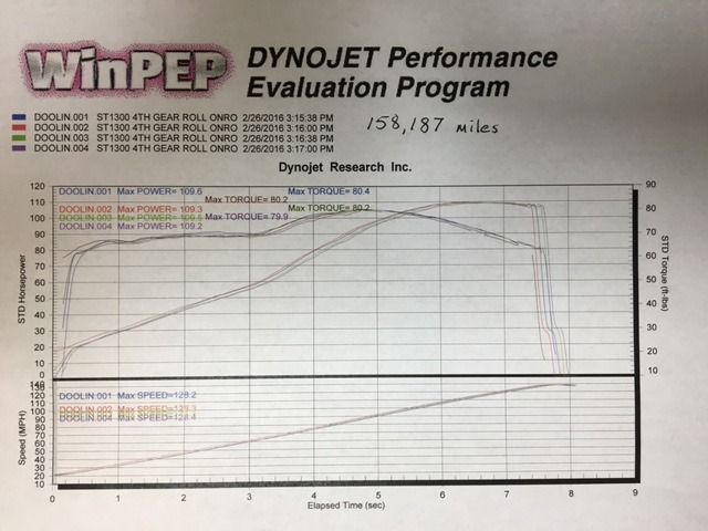

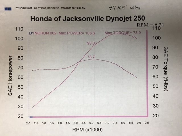

My ST1300 still pulls the same top speed it did when new and burns no measurable oil between oil changes but until I got a second dyno run today on my 2005 I wouldn't have believed it hasn't lost any horsepower or torque. I know that no two dyno runs are the same with variables of temperature, air density, fuel additives, etc. but these two are close and the second is actually more powerful by 3.8%. The runs are on the same dynometer (to my knowledge - it's at the same shop) and were done by the same tech as 6 years ago. 4th gear roll on.......20 to 128 mph in 7.7 seconds.
2008 @ 44,165 miles
2016 @ 158,187 miles
