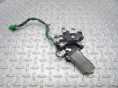

Somebody is selling the gears on eBay for under $9.00. LOL - they are printed plastic and should last about 12 seconds - that's a typo, I meant 1 or 2 seconds.
Seriously, someone is selling an adjuster mechanism for $375.
And a motor for $120:
