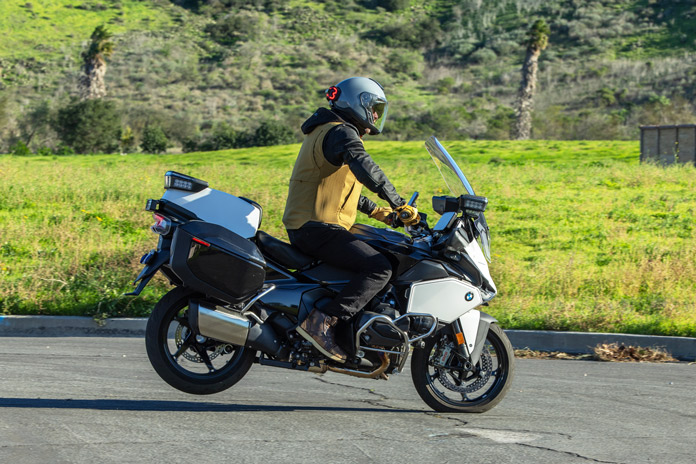

Step 1: Inline acceleration and threshold braking
Motor School with Quinn Redeker April 2026 Scrub-A-Dub-Dub
Start slow and gradually ramp up your threshold braking.
Just like it sounds, we are going to keep the bike in its upright position (tray tables stowed) and gradually accelerate and brake harder without adding any lean angle to the motorcycle. Using a large vacant parking lot, I typically do 5-10 inline runs at 15-30 mph. I make a point to use both the front and rear brakes during this process so that both tires get some scuffing. This initial step not only scrubs the center of the tire but builds needed heat in the rubber for when we begin leaning the bike. And don’t worry about getting into ABS, because you smartly chose a Trenner-approved location with tons of runoff. Good thinking!

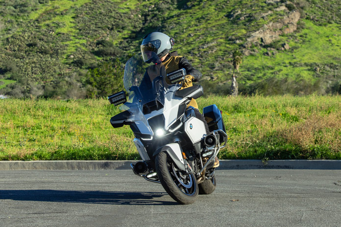

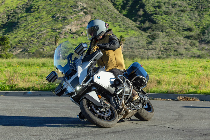

Step 2: Circles
During the circles, start off with minimal lean angle.
I start with a large, approximately 80-foot circle, with speeds around 10-15 mph. The key point here is to remember that we want to scrub every millimeter of our tires, so we need to go slow enough that the motorcycle’s lean angle is minimal in the first two or three laps. Then, rather than ramping up speeds to generate more lean angle, we will gradually work to tighten our circle, approximately 10 feet tighter after every four laps of the merry-go-round. This will safely scuff our new rubber as we go. Yes, we could simply pick up our momentum to add lean angle here, but the introduction of greater speeds never seemed wise, plus Trenner yelled at me once when I tried it that way. I’ll leave the final amount of lean angle up to you, because every bike and rider are different. For me, I go until my pegs and crash bar scrape because that represents the eventual lean angle I know I regularly generate in my day-to-day training and competition. But no matter how far you decide to go, do it slowly, carefully, and from a place of comfort all the way through the process. Once you complete one direction, rinse and repeat going the other way.
