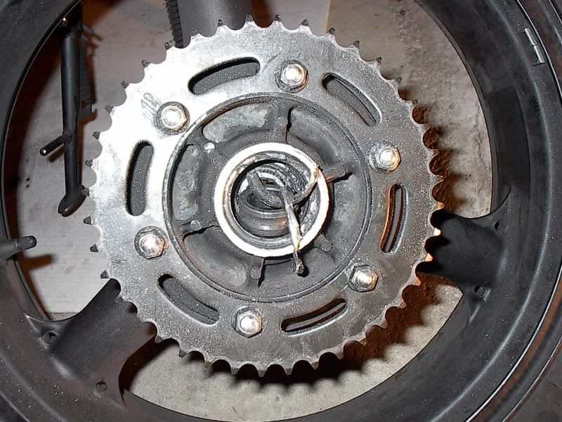

this is what a final drive bearing looks like when it completely blows up while riding, i almost died when this happened, since i had entered a corner at 110 and the rear end got super loose, i was able to save it .... this was on a kawi 750 and i'm happy to be around to tell the story ...
You probably only have 2 bearings on that wheel... .That's one nice thing about the ST setup... you're gonna hear some very strange noised to warn you before it ever gets that bad because if one fails the others will keep you up, hopefully long enough to get help.

The drive side flange bearing just failed at 15k miles on my 07' ST1300 also. I pulled the rear wheel to have a new tire mounted and found numerous metal shavings on the drive spline on the wheel and also inside of the spline on the final drive side. Further inspection revealed that half of the roller balls were missing from the bearing. I think that we all should check the bearings any time a wheel is removed.
I used the picture resizer Mellow gave the link to & the attachment is what my bearing looked like.
