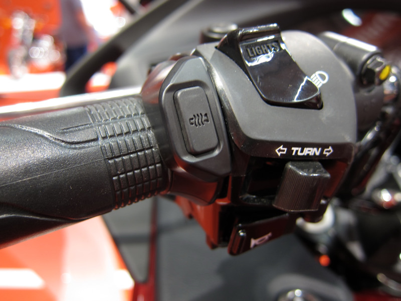

New version of Honda heated grips
Honda has released an updated version of their heated grips for the NT700. New is that the size of the grips are 5 mm less in diameter compared to the previous version of heated grips, and that a newly developed control switch is delivered together with the grips. This control switch has the same function as the previous one. First press sets the grips to maximum power and additional pressings lower the power. There are three levels of power. The button is illuminated and respond with flashes for power level 3, 2 and 1. The cost of the new version of heated grips should be the same as the previous ones.
My impression of the new device is that it looks very nice and "flush" with the grip and other control buttons. The "must have" thoughts rised up a step immediately :)
Part number is 08T50-MEW-800A for the grips.
You also need the cable harness 08A30-MEW-800 for additional 45 USD
Well, hock! One thing I liked about my ST1300 Honda heated grips was the larger-than-standard diameter.
