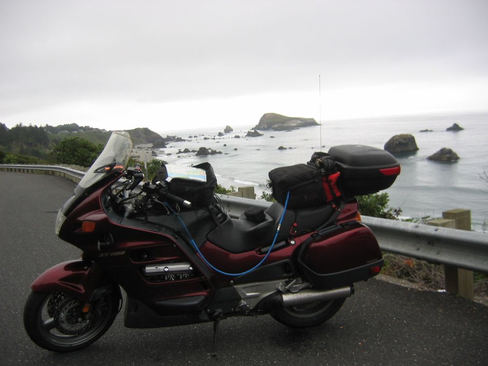

I got around both of those problems by attaching the tube to one of those retractable badge holders on my tank bag. See the picture in the top post in the thread below:
https://www.st-owners.com/forums/showthread.php?63619-Mick-s-Hillbilly-Hydration-System&highlight=
I used this setup on a 6000 mile trip and it worked perfectly! I encountered plenty of 100+ degree temps during that trip so the ability to drink from that tube while riding, then just let it go to be retracted by that badge holder really came in handy. Here's a picture of it in action:
This is a means of attachment that a couple of folks on the old ST1100 List used and none of them that I know of ever had any problems at all with the tube connected to a retractable lanyard like this.
