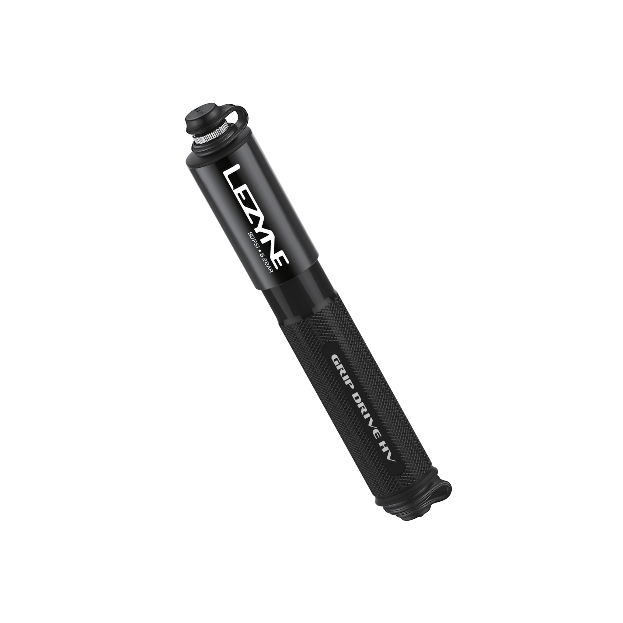

Same, but i also carry a Lezyne High Volume bicycle pump in medium size in case my mini China compressor fails.
2nd bike has the Alloy Drive in medium size which is more expensive but i cant really tell the difference. Both superb quality.

Looks like lots of Lezyne versions. Is this best for motorcycle use?
And have you used it?
Bigger the better but its really up to how much room you have to spare. They even make a Micro Floor Drive XL pump that would be amazing if you could fit it.
I've used the pumps twice over the years since i forgot my mini compressor. It takes some effort but you can get enough air to get you to a gas station to finish it.
