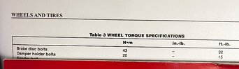

While tightening the damper holder bolts one snapped. My Clymer manual says 15 and the torque summary a member posted says 14. I checked my torque wrench calibration and it’s not far off. What is the correct torque value. I’m considering putting some blue thread locker on them and only tighten to 10 ft-lb.
