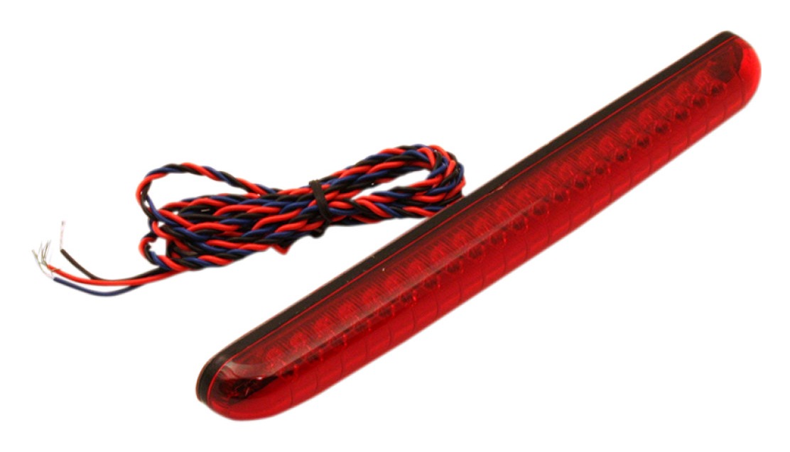

Check this one out. I've used it on several bikes now.
It'll do several modes of brake flashing, and will even do the Night Rider sequential lighting like Kit.

You have the option to have it do nothing but act as a brake light. My point is, you don't have to spend $250 to get much, if not all, the functionality. That light I mentioned above is only $40.
