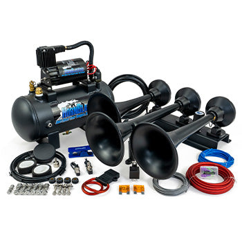

maybe I'm missing something, but given the current design approach:
1. when you tap the regular horn at someone who doesn't start when the light changes, 3 seconds later they're going to get the air horn blast, which probably isn't what you want.
2. if someone is about to run into you on the freeway, the air horn won't activate until 3 seconds later, which probably isn't what you want either.
I've to agree...
For "gaining attention" (i.e. SMOMBIE about to stagger out into the road) I can just blip the horn button...
And in any other situation I'm already in distress, hence want a full blare...
Besides that adding more components only increases failure rates...
Hence I've left the OEM horn untouched, only wired the relay for my high/low pair parallel to it, routed a fused 6mm² wiring from the battery through the NO contact... works since the 90ies...

This is the horn I purchased
Amazon's picture shows a 30 amp fuse protecting the relay and this horn circuit. I'd suggest you run #10 awg wire from the battery or an aux. fusebox to the horn relay, and then the same #10 from the load side of the relay to the horn. You can use the original horn wiring to trigger the relay. The specs say the horn draws 15 amps, but you have to consider voltage drop. Since this is not a critical application, you can probably get away with # 12 wire and a 20 amp fuse, but I'd opt for #10. The voltage drop would be higher with #12, but probably not excessive (I've not run the numbers).
And from the compressor - terminal to the battery - terminal or to ground.
The compressor will spool up and sound off a bit faster with the #10, too.
Correct polarity matters with compressors; they're louder when it's right.

I used the wire loom it came with, figured they know what it needs. It's instant on, I was hoping there would be a slight delay for it to kick on, but no

Road today, had an 18 wheeler start changing lanes on me, first time to see if they could hear me,
HE DID! Jumped back to his lane immediately
It's LOUD. Two snail horns back to back, harmonize to seam even louder. A very quick tap isn't to obnoxious, but a long press gets attention
Yep, pointed the trumpets of mine downward in front if the bike to reflect from the road surface...
