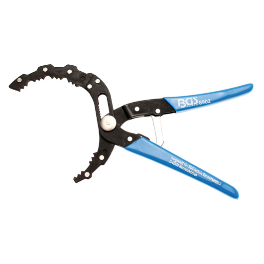

Not a fan of those cup style removers, I find they slip.
My favorite is this grip it style, the harder you torque it, the tighter it grips....
Check diameter to see if it will fit a ST oil filter
Dunno, might work on an ST, would never fit on bikes like my GF's NT700VA where the filter faces rear, right into the swing-arm pivot...
