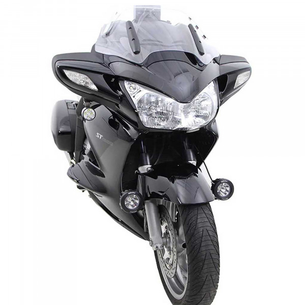

Where do you want to put them (mirrors, forks, elsewhere), and for what purpose? (conspicuity, fog, driving)
ST1100, ST1300?
To be seen, get a pair and mount them on the forks. You want to make a triangle of light so you don't appear to be a car off in the distance.
Amber or yellow stand out best, if allowed in your area.
Here's my 13.
The yellow fork lights are very visible (they also do white light), and not expensive.

Could you post some photos from the side or back showing how you mounted the Zmoons please? I like your set up. Also what are the driving lights mounted to the side of the OEM headlights?
Obo
Oct 22, 2019
4,275
East Coast Canada
'03 ST1300A
This thread shows the way I installed them. I removed the fender reflector, bolted in the existing hole, moved the reflector to the outside of the LED.
The under mirror lights are just your run of the mill LED lights. Good for conspicuity but not all that great for extra lighting - at least with the upgraded headlights when I;m in the seat. They do make a difference though, just not as much as I'd like. These are what I used as I had them on hand. https://truxaccessories.com/product/3-mini-rectangle-led-work-lamps-pair-combination-spot-flood-beam-900-lumens-each/
If I wasn't so cheap I'd have bought the driving lights @spiderman302 suggest in the lighting thread. If I had my way I'd do rally-car-night-to-day kind of lights.

I think those zMoons are a huge bang for the buck. That yellow really stands out for conspicuity.
I wonder if mounting them wire up is really necessary to be seen down range. The sooner you're picked up on the other guy's radar is great for fighter jocks. But how far away do you need to be seen as an oncoming vehicle? In other words is there any benefit to being seen when you can't possibly a "threat" to someone else.
Might not the wire down orientation be sufficient to be seen in plenty of time? Naturally knots closure makes a difference. This would let the white light illuminate the road a little farther ahead. Would this be at the expense of filling in the area in front of the bike. Anyway the zMoons are really appealing.
Obo
Oct 22, 2019
4,275
East Coast Canada
'03 ST1300A
Wire up on the zmoons (like how I have mine) results in a shorter throw for the yellow and a longer throw for the white.
Wire down would make the yellow throw father and the white less.
I wanted my whites to go farther for night time use and fill in where the high beam didn't.
The yellows are more than bright enough throwing "shorter" this way.

I use the zmoons just like Obo. Easy mounting on the lower forks, and very visible, especially the yellow.

+1 for the zmoons. I also mounted them on the forks. I had one fail shortly after I installed them so I bought another pair and kept one as a spare. Not a big deal since they are so cheap. No issues since.
I also installed a Skeen Intelligent Dimmer module so I can dim them at night and not blind oncoming traffic:
You can use a switch and/or tap the high beam.
