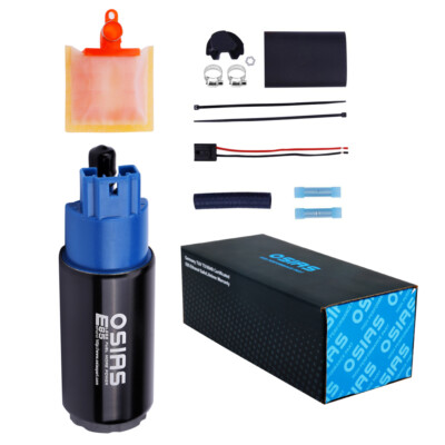

Handy article for folks!Tonight I replaced my fuel filter and while I was in there I tossed in a new fuel pump. The bike has 94000 miles and I had some bad fuel a while back and have been wanting to replace the filter. A member here mentioned another fuel pump option rather than the entire assembly option that Honda has for $400. The fuel pump motor in the ST1300 is a common automotive pump. I would post the link to ebay but it will be gone soon and just be a dead link the model number listed is:
HFP-382
A Google search of that will result in several options. The kit I bought off ebay was $68. Here is an example of the kit. (note over 400 vehicles use this pump)
High Flow Pump
The one problem with this option is the small sock that attaches to the pump pickup has to be reused. Honda doesn't sell this part. While I was in there I also replaced the Fuel Filter (16900-MBG-013); Filter, Fuel Return (16714-MBG-000) and when the assembly is removed you should replace the gasket (17574-MN5-000) which seals the fuel pump assembly. There are also some crush washers on the banjo fitting that could be replaced if you are ordering parts anyhow. I don't have the part number handy.
