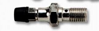

Although Larry offered to walk me through the process of bleeding my brake lines, I thought I’d try it myself first. After all, I have successfully flushed the brake lines before and thought I knew the process well enough to do it on my own. I was so wrong!
Completely draining the front and rear brake lines introduces a lot of air into the system. I had anticipated that. However, I had not anticipated all places it would get trapped. Although I was able to get a good bit of air out of the rear circuits, I was unable to get all of it. The front circuits were a whole different story, and my best description of what was coming out of the right caliper circuit looked more like foam than fluid. Nothing I did improved the situation.
This prompted another call to Larry on the White Courtesy Phone. Over the next hour and a half, Larry coached me through his process of purging the air.
First, he had me remove the banjo bolt to the front master cylinder (already filled with brake fluid) and asked me to pretend like I was the little Dutch boy by sticking my finger where the bolt had been. Next, he had me gently flick the lever, and tiny bubbles would rise to the top of the reservoir. Then, he had me slowly squeeze the lever, which cause air and fluid to escape past my finger. Before releasing the lever, Larry instructed me to replace the banjo bolt and tighten it finger-tight. He had me squeeze the lever again while slightly loosening the banjo bolt to allow some additional fluid and air to escape. Before releasing the lever this time, Larry instructed me to tighten the banjo bolt. Good and tight is sufficient. In the process of juggling everything, I must have partially released the lever, because there was little resistance when squeezing the lever. Consequently, I had to repeat the process.
Lesson 6, don’t release the lever until your bleeder screws and banjo bolts are tight – lol.
After that, the remainder of the process was similar to the standard flush and fill process, but not identical. Before bleeding the proportional control valve circuit (PCV), Larry had me use the push rod to push the piston in on the SMC and lightly tap it with a wooden dowel. The first time, the piston inside the SMC moved quite easily. After bleeding the PCV, he had me push the piston in a second time and tap the SMC some more. This time, it took a little more effort to move the piston. After bleeding the PCV circuit again, Larry had me push the piston in a third time. Significantly more effort to was required to move the piston this time and I also tapped the SMC some more. Eventually, I was getting clear fluid out of the PCV bleeder and the air was gone. Voila!
Lesson 7, pushing the piston in on the SMC while bleeding the PCV helps purge the air from that circuit.
The remainder of the bleeding process was identical to what I had done before. Although, I would note that Larry had me pounding the rear pedal between bleeds. He also had me tap on the rear caliper and brake lines. Eventually, I got clear fluid with no air bubbles! At that point, I thought I was done. Again, I quickly learned that I was wrong.
Subsequently, Larry had me place a weight on the rear pedal and tie up the front lever and told me to leave them that way overnight. This puts pressure on the various brake lines. Apparently, this is a time-honored means to corral the remaining air trapped in the system.
The next day, Larry had me remove the weight and release the lever. To my dismay, both the lever and pedal were still slightly spongy. Before I knew it, I was going through the entire bleeding sequence again. Apparently, the remaining air in the brake lines found its way into the calipers. Bleeding the system this time would eradicate the last traces of air in the system. Now, both the lever and pedal were nice and firm. This technique was extremely helpful!
Lesson 8, you are not done bleeding your ST’s brakes until you’re good and done.
