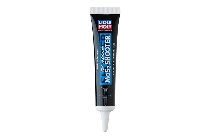

And then there's this:
A Moly oil additive that they say is safe for wet clutches.
