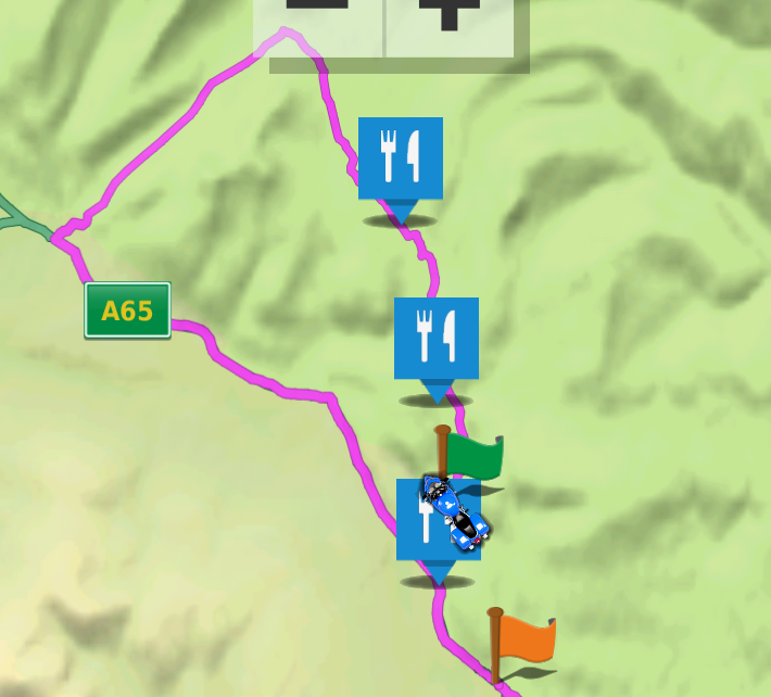

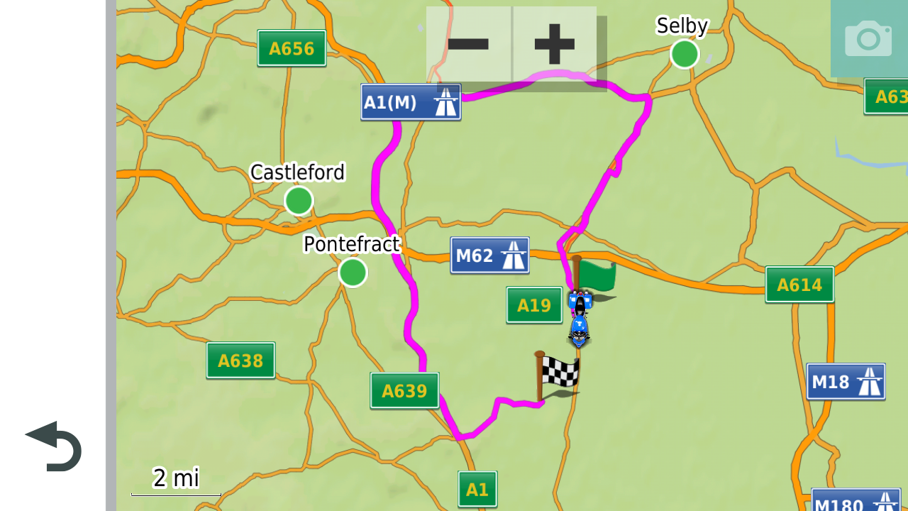

The Repeated U-Turn behaviour - for which I coined the term "RUT" (as in being stuck in one) is most likely to show itself if the route has recalculated, and you subsequently go off route.
Then rather than navigating to the next route point, it spots the closest point on the route it has just calculated - which is nearly always behind you, and takes you to that.
It never happens for routes that are created on the XT itself though - a discovery that I stumbled across while out testing and needed to rebuild a route at the side of the road. It then behaved perfectly. That led to the discovery by FrankB that there was a single flag and later that a route could be set to saved just using the XT screen.
