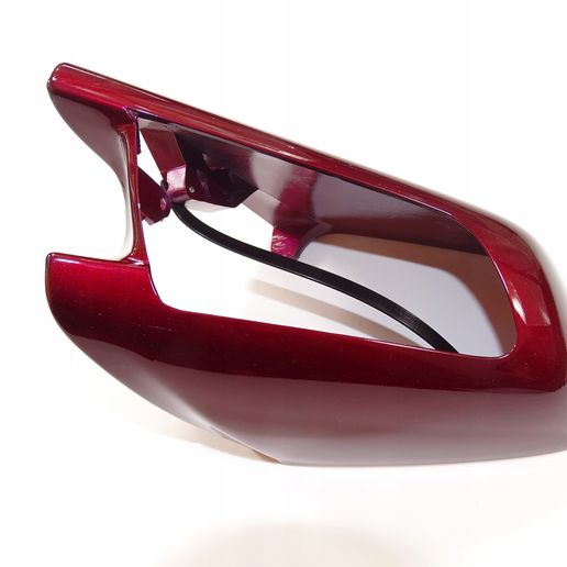

Has anybody done any experimenting with scanning and printing ST1100 mirror covers? They are almost impossible to find anywhere. The ones I have have been repaired from a previous life. I'm in the process of picking up a 3d printer. I'm trying to get some good scans to see if they can be printed with carbon fiber filaments. It would take some work to get a printed cover to take paint and mounting but it would be a good winter project.

I have great news on the cover project. I got my printer and have been playing around with printing the Rocinante as a means of getting to know how the printer works. Bit of a learning curve with that. I used a PLA Carbon Fiber filament and the 9 hour job finished this morning. I printed the right side cover and it came out better that I could have hoped. It fits directly onto the fairing, as is, with no mods or changes. The scan was detailed enough to accurately dimension the three mounting studs. Even the studs for the light subassembly screws are there. The mounting studs work for now but will probably need to be replaced with metal studs for permanent use. I'll try to post the .STL and .3MF files but they are pretty big. The carbon fiber finish is kind of cool by itself. I'm not sure how well the naked finish would handle long term sun and weather. I suppose a clear polyurethane topcoat may help. Fairing, sanding and proper automotive painting processes would be needed for color-matching but the base part came out very well.
