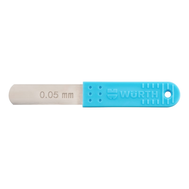

Thanks for lots of good information and guidance. Preparing well but getting valve gauge blades was not easy, have been promised to get valve gauge blades from Würth on Thursday.

The spark plugs are already out as I have tried to measure valve clearances but with too big jumps between valve gauge blades I am waiting for a set of valve gauge blades which were not in stock at Würth anyway as I was told.
Good tip by having a large flat bladed screwdriver to tweak the split cam drive gears upon installing :thumb:
Got those (5 piece set, bend accordingly), slightly disappointing that they're only avail in 0.05mm steps though...

I have searched online for a Feeler Gauge Set that is good to use for valve adjustment where the valves have shim adjustment to get the most accurate measurement possible. But I can't find anything that is perfect.

Not buying into the simple method using SAE thousandths of an inch, huh? For 15 Euros you can get these SAE feeler gauges sent to Norway IINM/FWIW/YMMV/JMHO:
https://www.amazon.co.uk/Spurtar-Blades-Measurement-Measuring-Thickness/dp/B07B3TQQSV
Edit: ah shoot, I thought these were just SAE, not dual marked. Well, I’m sure they have a straight SAE only set, dig a bit deeper. You get my drift anyway, they’re available to Norwegians. :)
The sizes you'd listed look like inch values in mm... I'd confirm with micrometer while using them...
I just noticed this. I agree with my long-time friend, Martin. Appears to me SAE feelers. From the post (#31) above:
.005”=0.127 mm
.008”=0.203 mm
.010”=0.254 mm
Edit: with the set that you ordered above, I’d say you’re good to go to measure valve clearances in thousandths of an inch. Can’t adjust a clearance any finer than that anyway, unless you shave a shim or special fabricate one thinner than OEM.

I agree with you there, what I have seen so far after measuring all the valves with the feeler gauges I have had lying around for many years. All the valves are within tolerance range except for both intake valves on cylinder number 2 which I have measured to 0.05 mm and 0,03 mm, here the camshaft must be dismantled for new shims so the measurement comes within 0.13 - 0.19 mm
Before I do anything I will take a new measurement of valve clearances as soon as I get new feeler gauges which are supplemented with the ones I already have. Got new head gaskets today :thumb:

Thank you :thumb: I basically want to buy the Feeler Gauge Set in mm, always worked with mm which Honda also operates with, I will continue with that.
FWIW, here is my collection of valve clearance tools. Once I figured out the inch method, for my ST1100 I only need/use the nine feelers (4-12 thousandths) on the chain at the bottom of the image (click on it for a nice clear picture):
